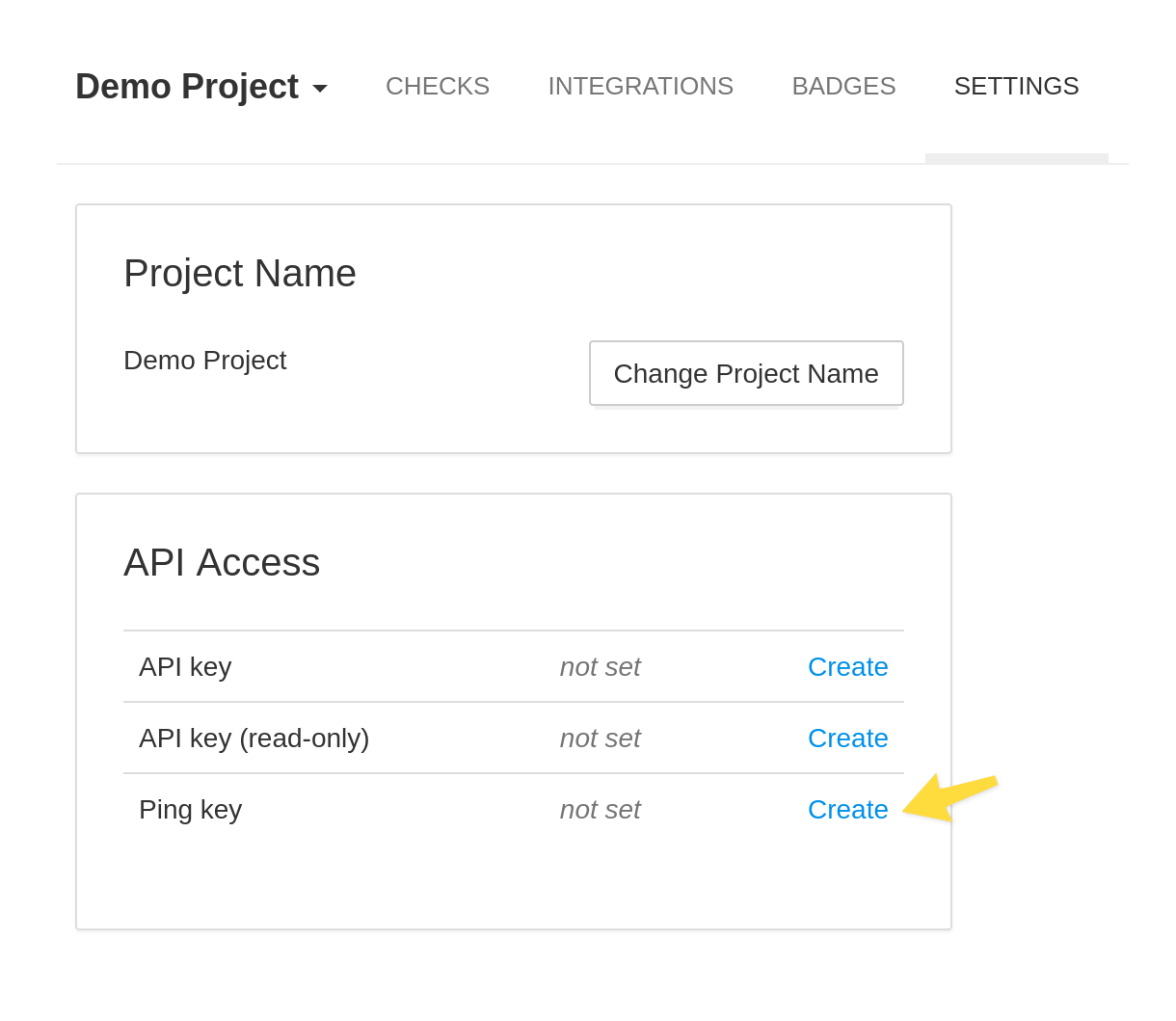

All checks in a single project share the same ping key. The ping key is the only secret you must manage to ping any check in the project. You can look up or create the ping key in your project’s Settings screen, right next to your project’s API keys:
Ping Key in the Project Settings page

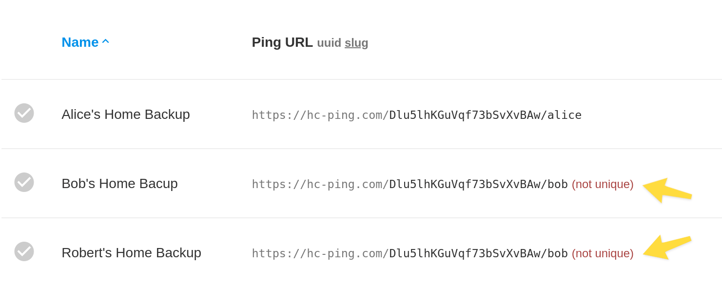

Duplicate Slug Values
SWS Check does not force you to pick unique slug values. If several checks have the same slug, they will have the same slug-based ping URL. If you send an HTTP request to it, you will get an HTTP 409 response with the text “ambiguous slug” in the response body. The UUID-based ping URLs for these checks will, of course, still work.
The SWS Check web interface will also warn you about any checks with the same slugs:
The checks list page showing a "duplicate slug" note

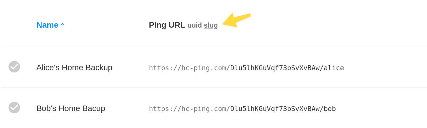

SWS Check shows a "UUID / Slug" selector in the checks list:
The uuid / slug selector in the checks list page

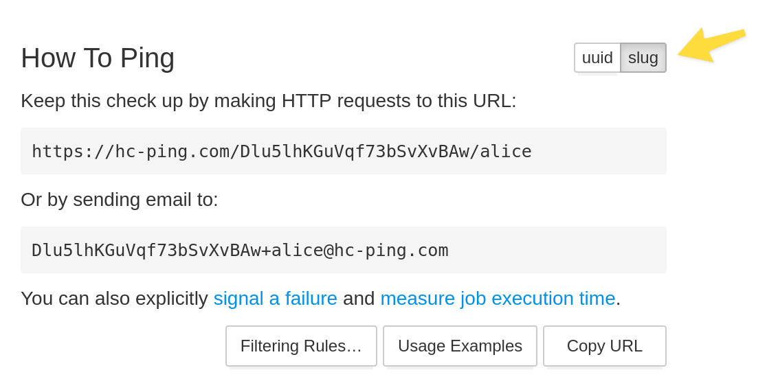

And also in each check's details page:
The uuid / slug selector in the check details page
The selector lets you choose the URL format for display in the web interface. It controls the display value only, and does not influence the operation of pinging API: SWS Check will accept ping requests using either format, regardless of the selector value.
