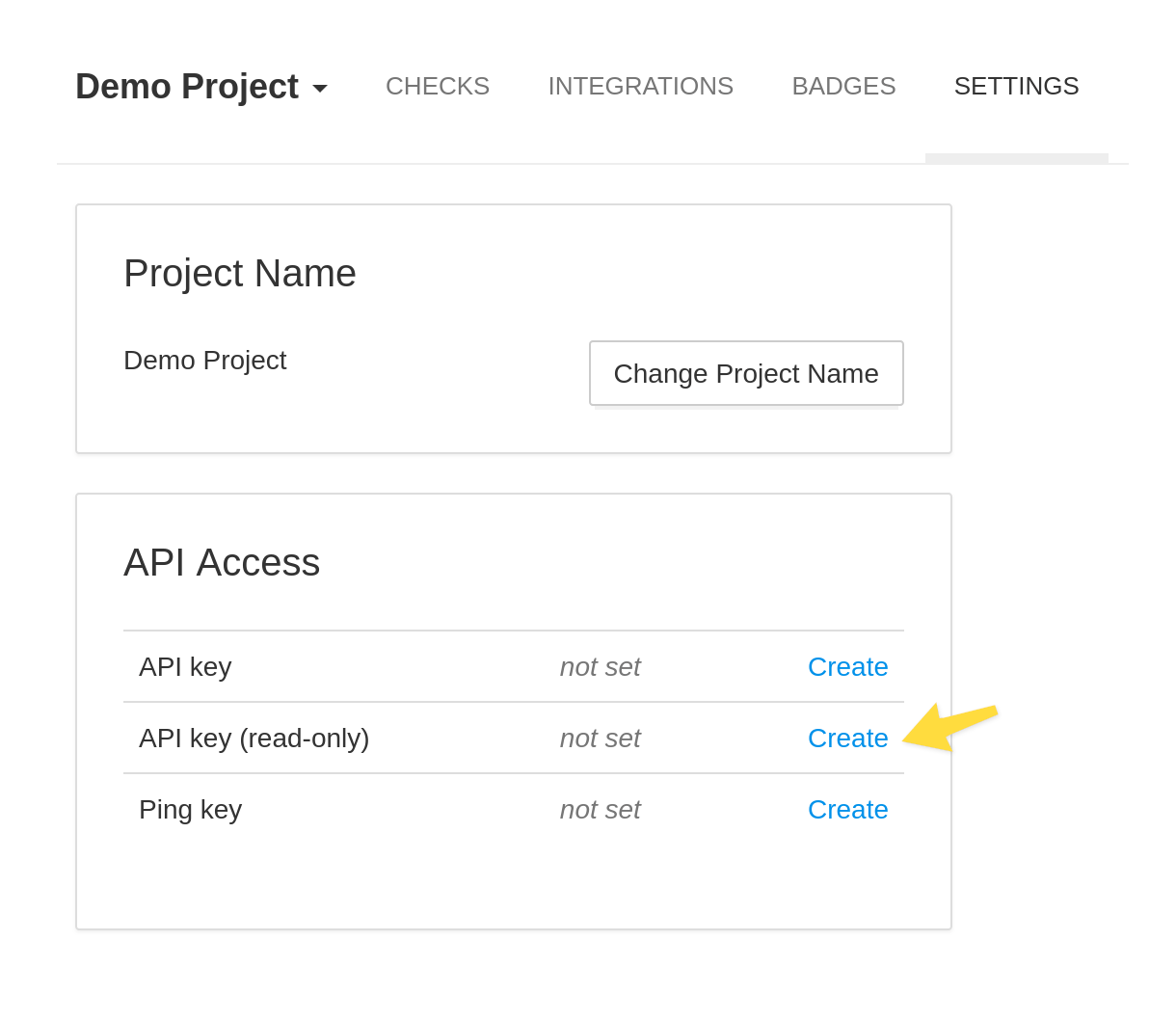

Create read-only API key
Create a read-only API key in Project Settings › API Access.
Make sure to use a read-only API key. Prometheus does not need read-write API access.
Project's API Keys
