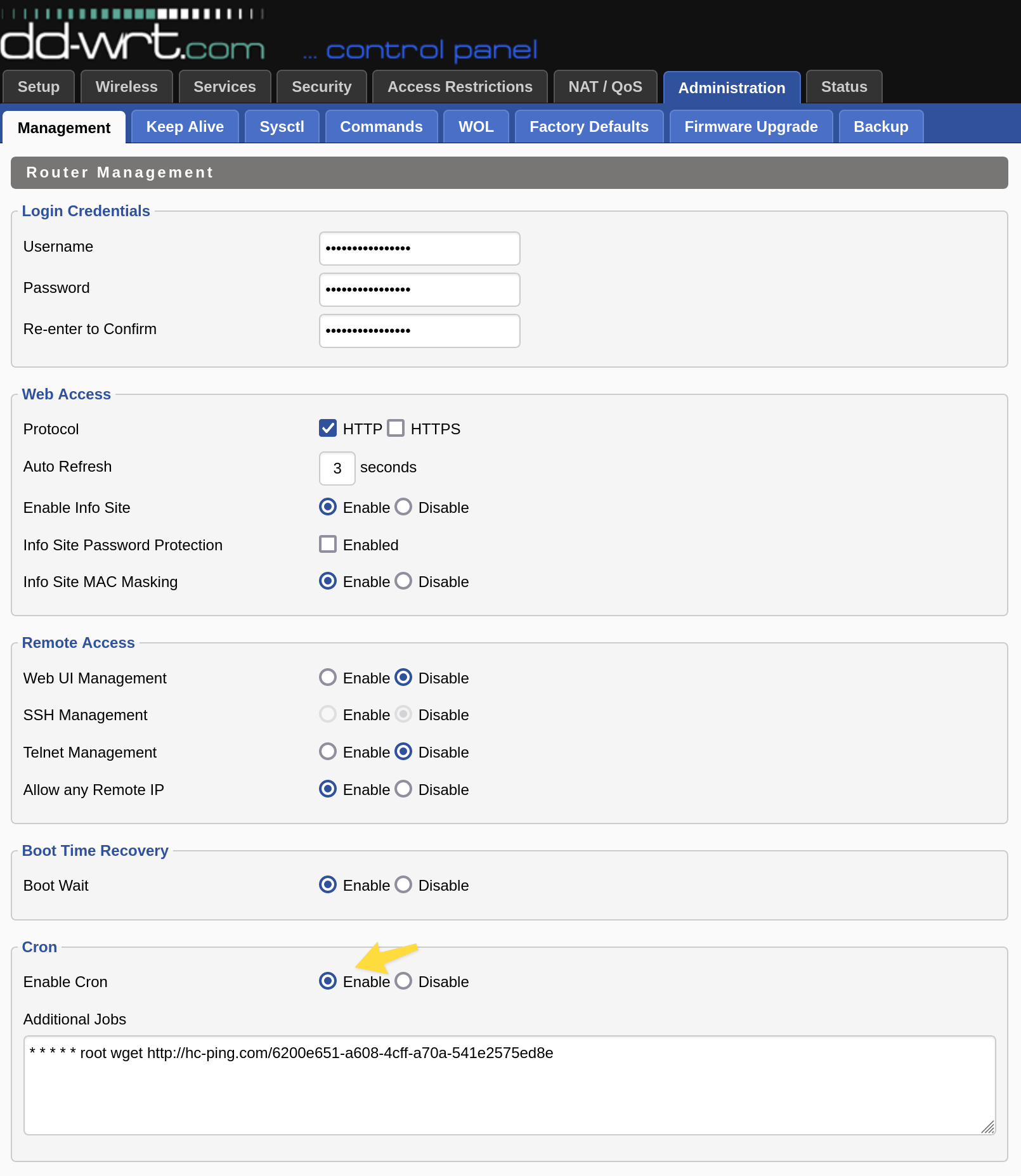

DD-WRT
DD-WRT is a Linux-based firmware for routers that runs on wide variety of router models. DD-WRT ships with a cron daemon and wget utility. You can enable the cron daemon and edit crontab in DD-WRT control panel, Administration › Management › Cron.
The crontab syntax on DD-WRT is:
[cron expression] [username] [command]
Example for sending a ping every minute:
* * * * * root wget https://check.sws.help/ping/your-uuid-here
Screenshot:

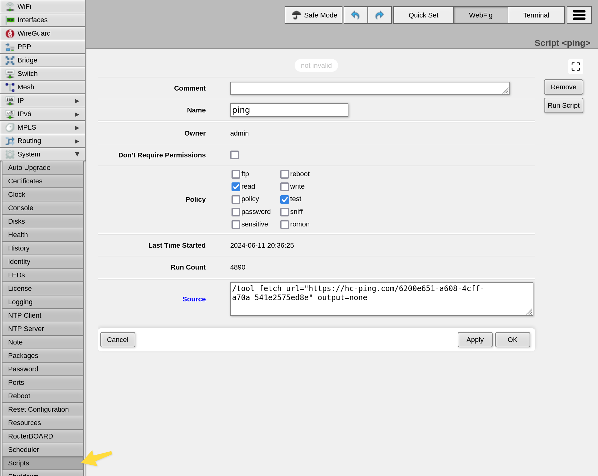

First, create a script in WebFig, System › Scripts › Add New. Use the following parameters:
  • Name: ping (example, you can use a different name)
  • Policy: read, test
  • Source: /tool fetch url="https://check.sws.help/ping/your-uuid-here" output=none

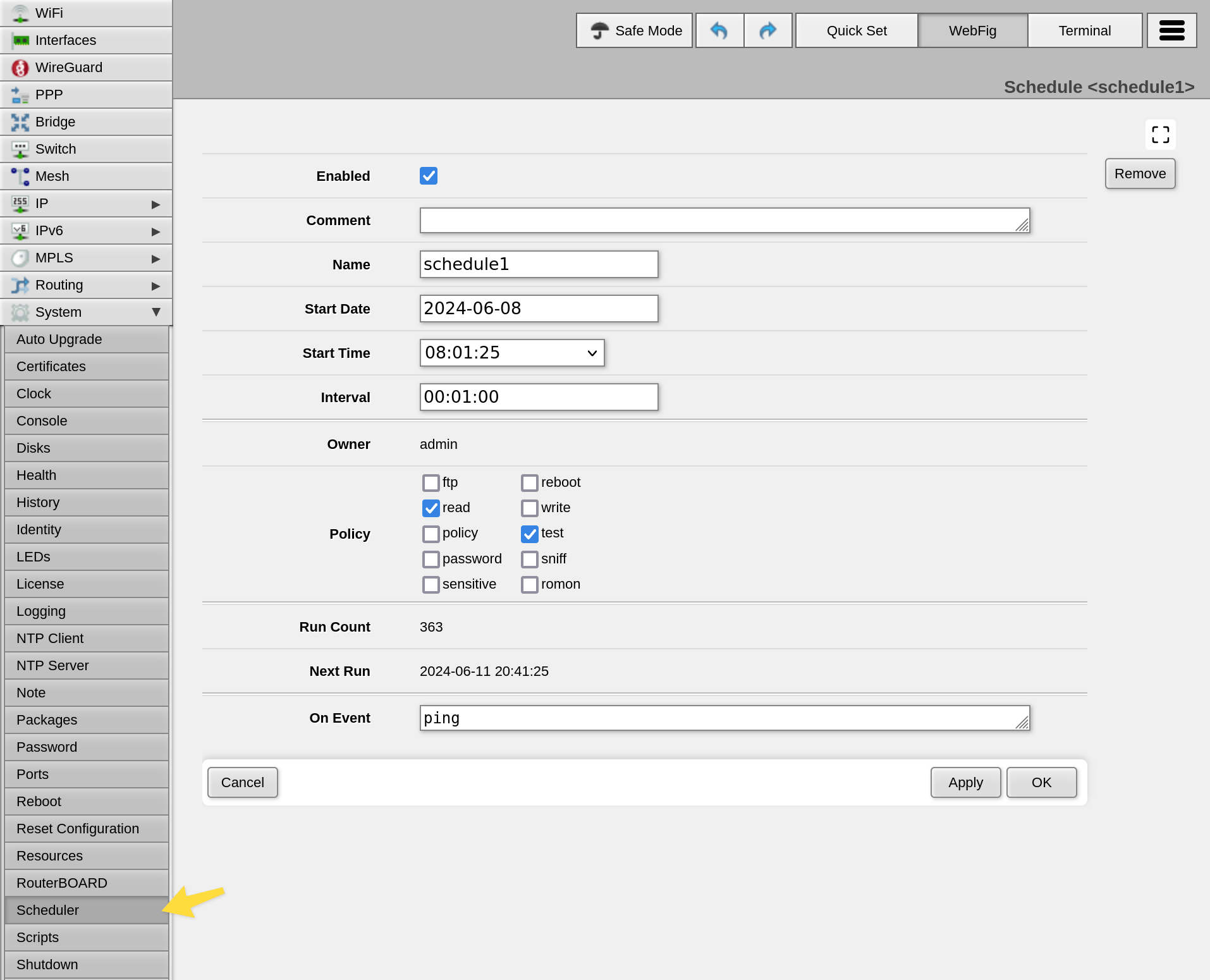

Then, create a schedule in WebFig, System › Scheduler › Add New. Use parameters:
  • Interval: 00:01:00 (one minute)
  • On Event: ping (the name of the script from the previous step)
Notes:
  • The output=none parameter tells the system to discard response body. Without this parameter, the system will save response body to a file, which will additionally require the write policy.
  • The "tool fetch" utility supports HTTPS URLs but does not verify TLS certificates by default. You can add check-certificate=yes parameter to require a valid TLS certificate. Note that RouterOS ships with no root CA certificates, so you will also need to load these.
  • Here's the full list of options supported by "tool fetch".
