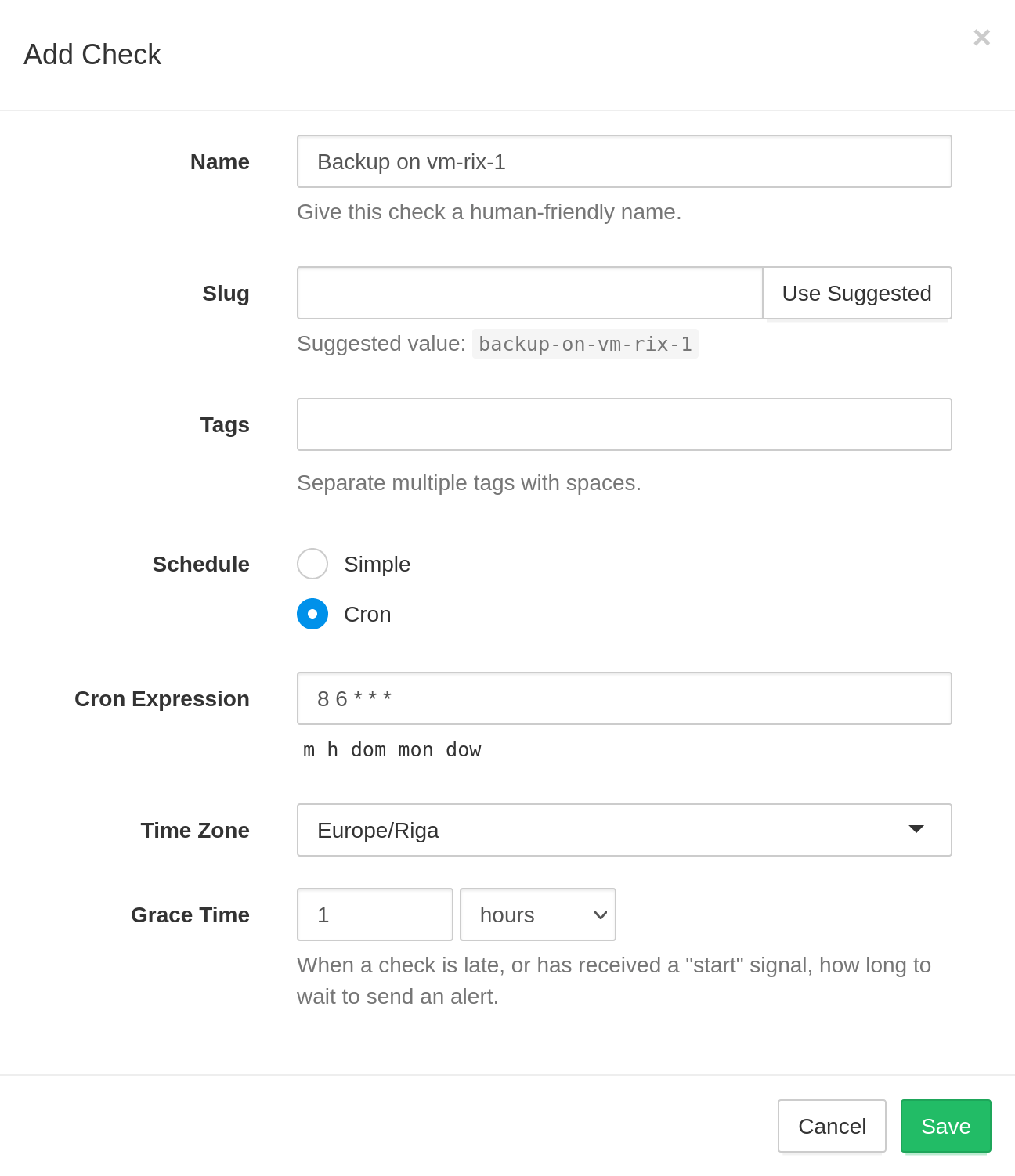

To monitor it, first create a new Check in your SWS Check account:
The "Add Check" dialog
After creating the check, copy the generated ping URL , and update the job's definition:
